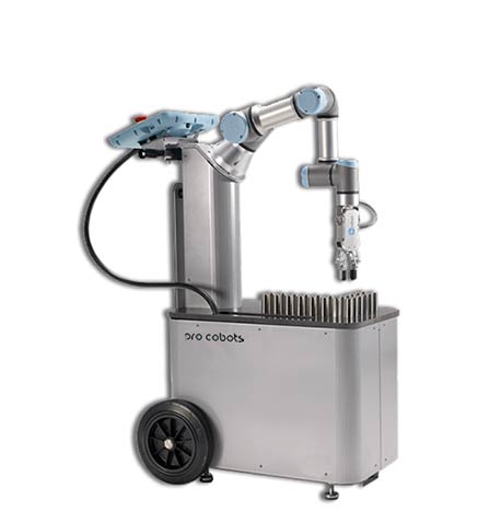

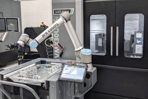

ProCobots cobot cell at a Hurco VMX with auto door
ProCobots cobot cells
A Universal Robots cobot on a mobile cell, tending the machine from part trays or drawers. Teach it positions by hand, queue jobs in the Hurco Automation Job Manager, and wheel it to another machine when the work changes.
Robot payload15, 20 or 30 kg
Batch sizeSmall to medium
Safety fencingNone needed

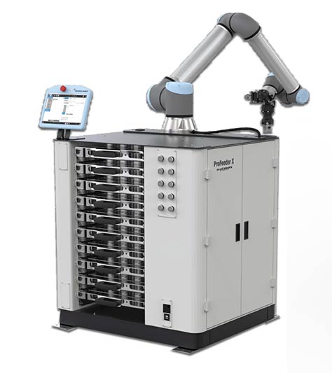

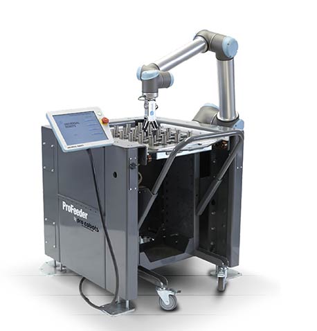

ProCobots ProFeeder X drawer cell
ProFeeder X
  • Compact, high-capacity robot cell.
  • Configure with 5 or 10 drawers to match production capacity and part sizes.
  • Three-position drawers let you load and unload parts while the robot is running.
RobotUR15
Max payload15 kg
Max reach1,300 mm
Size (W x H x D)890 x 969 x 1,008 mm
Max part height160 / 80 mm
Max load per trayApprox. 90 kg

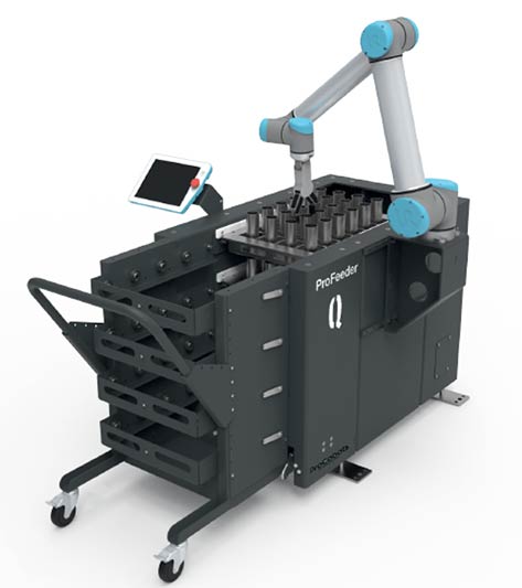

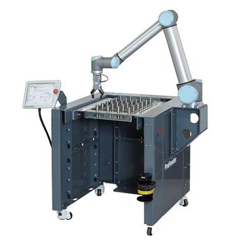

ProCobots ProFeeder Tray
ProFeeder Tray
  • Good for small-series machine tending.
  • Manually changeable part tray.
  • Heavy-duty levelling castors can be fitted.
  • Easy to move to other CNC machines.
RobotUR15
Max payload15 kg
Max reach1,300 mm
Size (W x H x D)1,165 x 800 x 900 mm
Max part height160 mm
Max load per trayApprox. 300 kg
Weight without robot250 kg

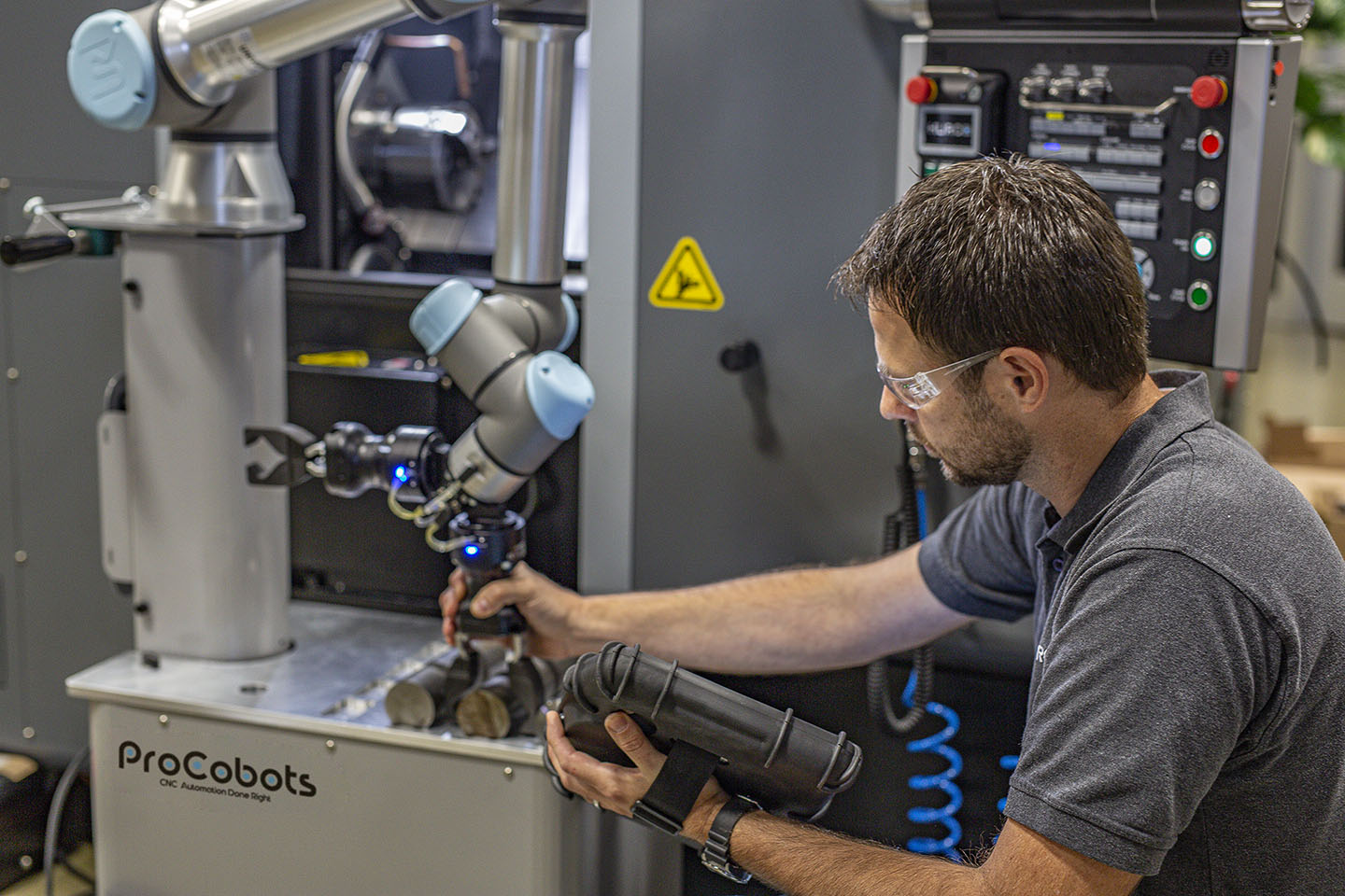

  • 6-axis collaborative robot that stops safely on contact and is programmed by moving it to teach positions.
  • Robot stand, cart and drawer systems to suit your production.
  • Collaborative front-load auto door: stops and reopens if obstructed.
  • Force sensor gives the robot a sense of touch.

Easy to use: Conversational set-up and programming, no robot language, positions taught by hand.

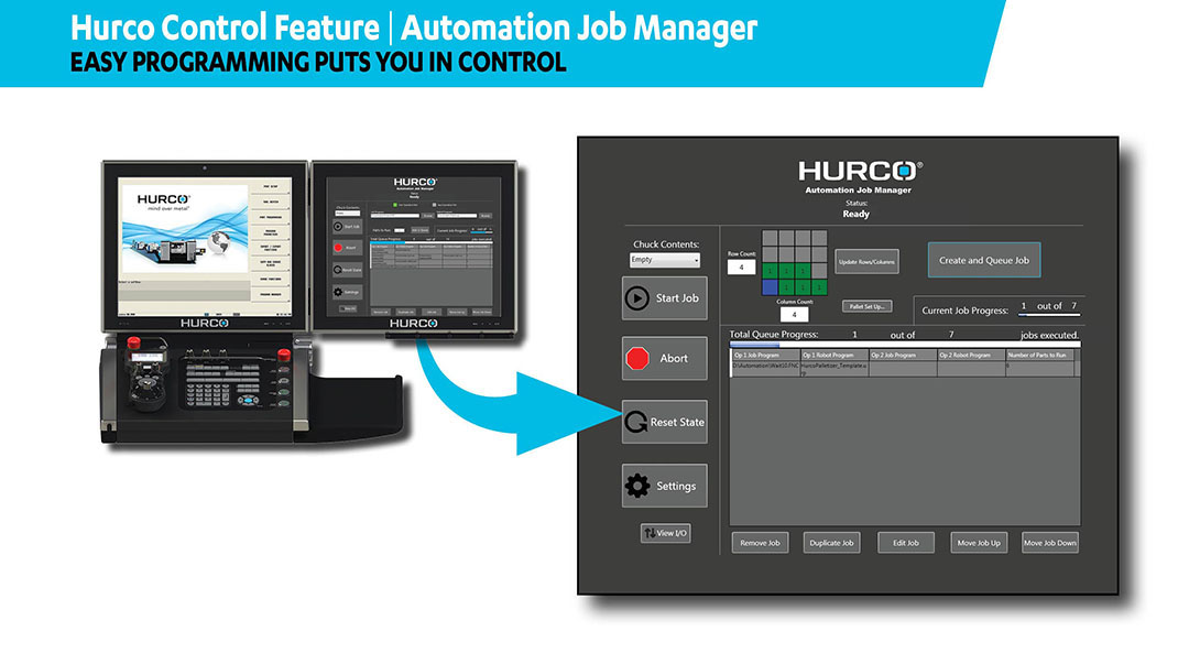

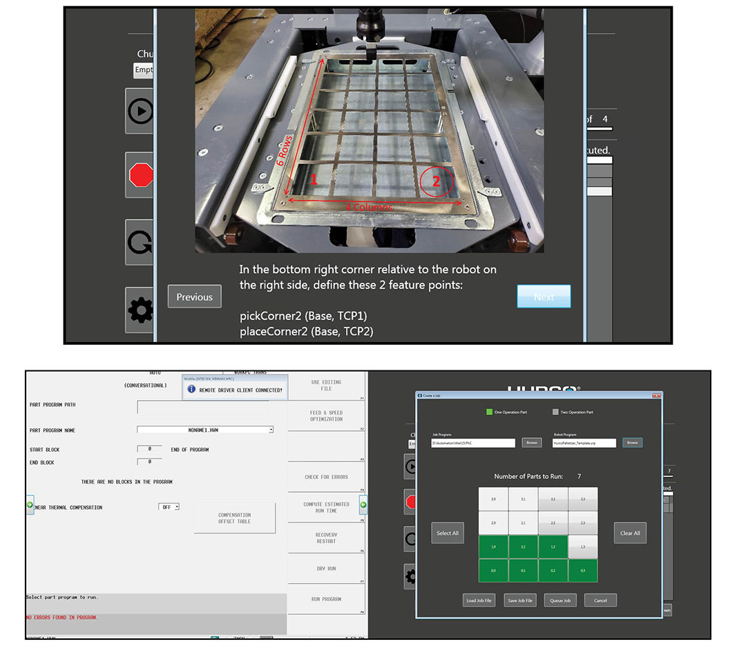

Automation from the Hurco control
The Automation Job Manager was written for shops that have never run a robot. Straightforward screens, the information you need, and nothing to learn beyond the control you already use.
Hurco Automation Job Manager screen
Runs on the MAX 5 control or a separate PC, with an Industry 4.0 network connection to WinMax® and the robot controls.
  • Easy job set-up with the robot-CNC graphical interface.
  • Job and queue progress bars.
  • Run multiple jobs sequentially.
  • Setup Wizard for part trays.
  • Load and save job set-ups.
Setup Wizard teaching tray positions
The Setup Wizard
Guides you through programming new jobs and custom part trays by teaching robot positions: move the robot by hand and store the position.
  • Prioritise, edit and remove jobs.
  • Select the robot exchange and CNC part programs.
  • Click on the grid to set stock material locations.
  • Add the job to the production queue.

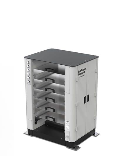

Included
  • Robot pedestal and cabinet assembly
  • Robot gripper with fingers
  • 6 shelves per cabinet, 2 stations per shelf (12 stations per cabinet)
  • 1, 2 or 3 cabinet option
  • Cleats for pallets and fixtures
  • Safety scanner and safety mat
  • Interlocked access doors
  • All wiring and pneumatics integrated
  • Hurco Job Manager software
  • Auto door and utility box
