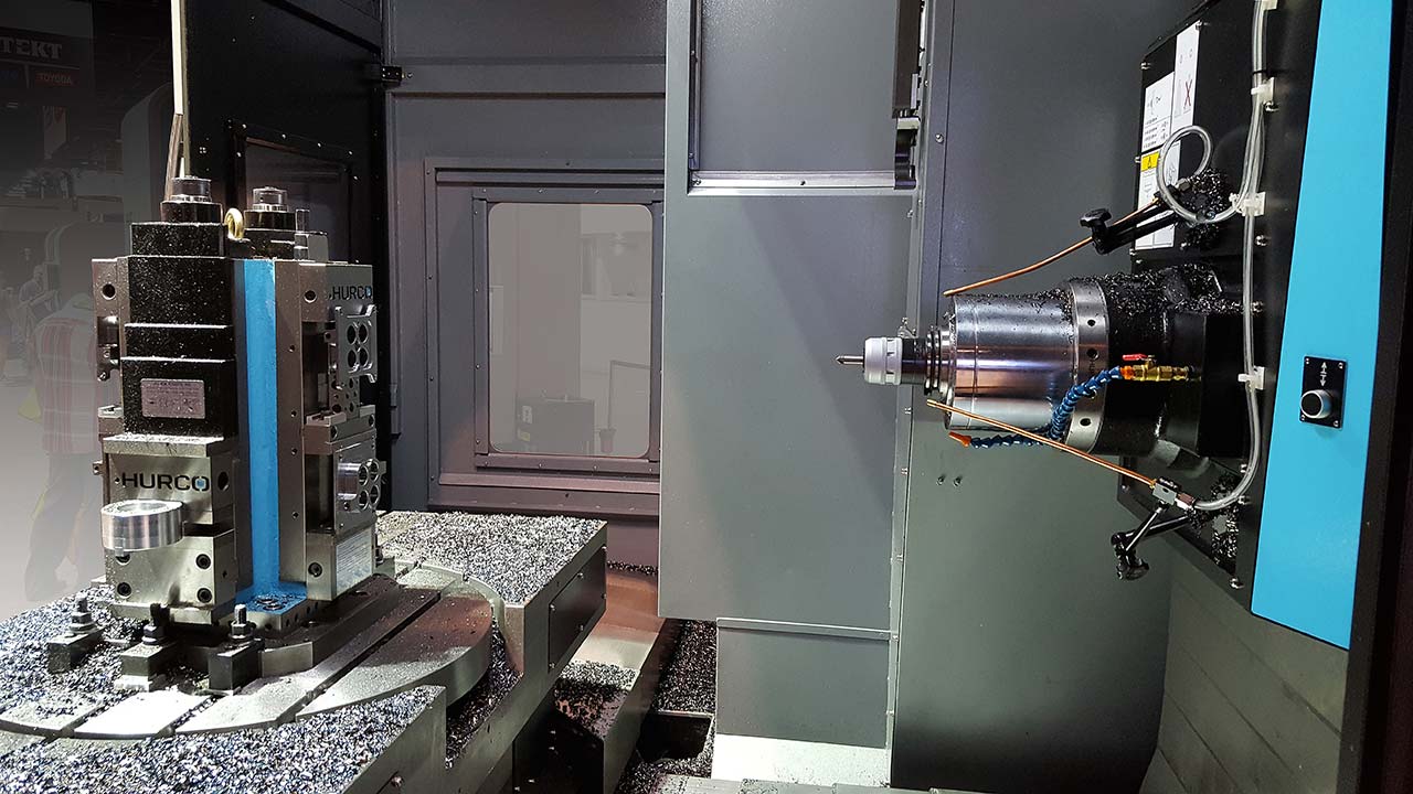

These economical, 3-axis and 4-axis  large travel horizontal CNC milling machines have an 8,000 rpm motorized spindle that is equipped for both high and low-end torque operations. The large, front and side access doors provide maximum operator efficiency. With fast rapids, large work cube, smart frame design, and UltiMotion technology, complex production parts can be CNC machined efficiently and accurately. Hurcos' horizontal milling machines increase shop productivity with a rotary torque table, such as the table added to the smart design of the HM1700i CNC machining centre.
Horizontal Machining Center Hurco HM1700Ri
Horizontal CNC Mills Designed for High-Mix Production
  • Heavily Ribbed Fine-Grade Cast Iron Frame Optimised with Finite Element Analysis (FEA)
  • 800 mm torque table
  • Linear roller guideways on XYZ axes
  • Full B-Axis (360 degrees / 360,000 position)
  • 8K rpm dual-wound spindle / 298 ft lbs of torque
  • 10K spindle option available
  • Practical design with large front and size doors for easy access
  • Patented UltiMotion motion system included
  • Direct drive B-axis table (torque table)
